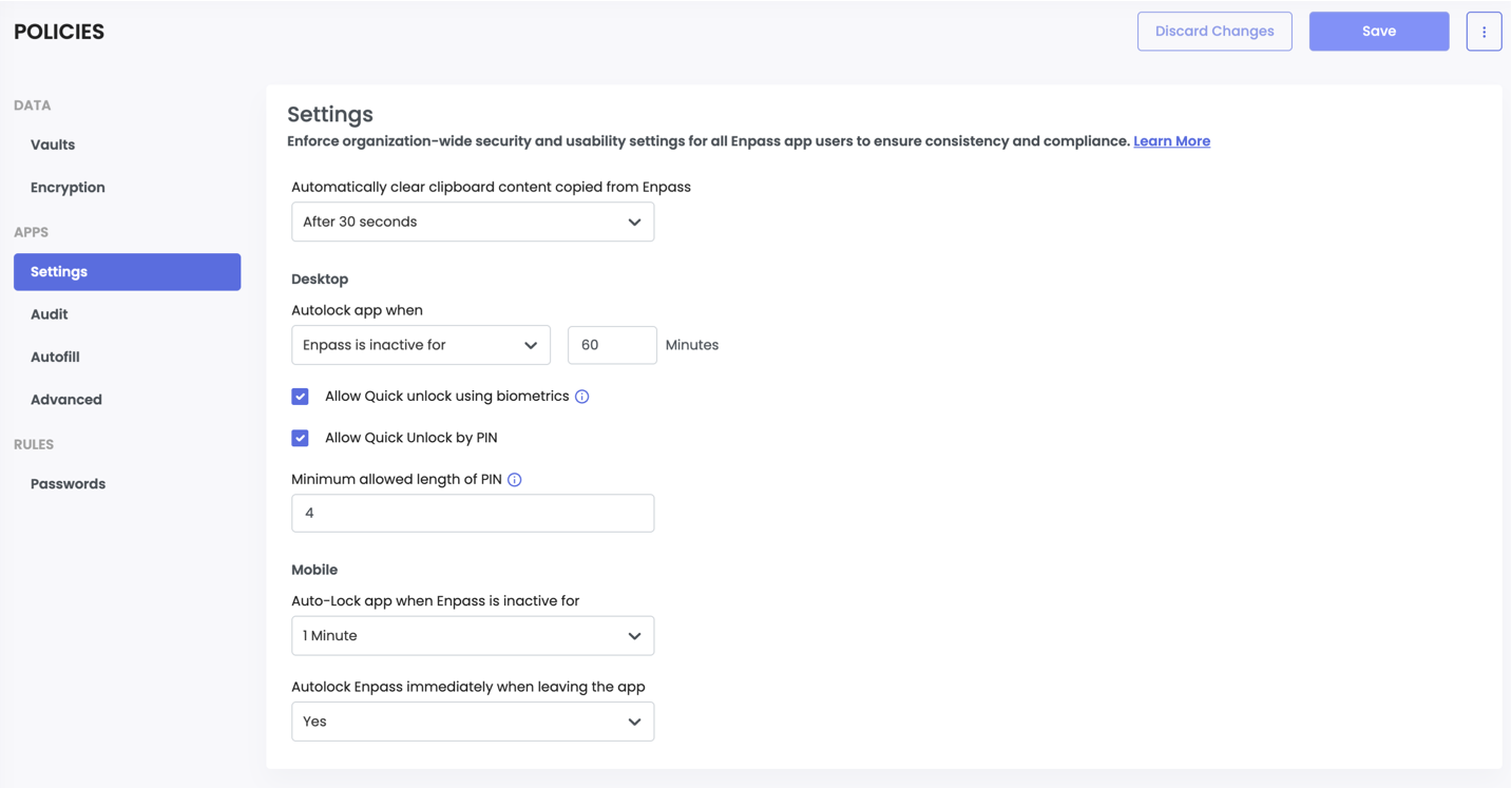

Enforce organization-wide security and usability settings for the Enpass app on all user devices. These policies help maintain consistency and compliance across your organization by controlling how the app locks, unlocks, and handles sensitive data.
To configure these policies, go to Policies > Settings in the Admin Console.
How to Configure App Security Policies
Log in to the Enpass Admin Console with an administrator account.
Navigate to Policies in the left sidebar.
Under the APPS section, select Settings.
Adjust settings using the checkboxes, drop-down menus, and input fields.
Click Save in the top-right corner to apply your changes.
Tip: Use Discard Changes before saving if you need to revert uncommitted edits.
